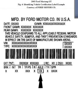

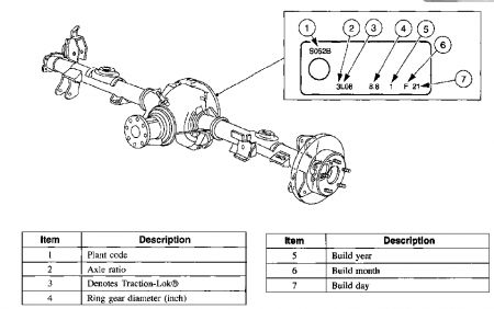

this is a gt what size is the ring gear. 7.5 or 8 inch. Or do I have to take the housing cover off to find out?

If you have a limited slip(posi) it's 8.8 inch there are two ways to ID it shown here, One is the door label, and the other is the tag on the axle.
