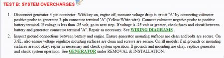

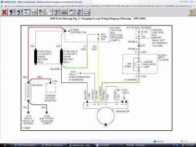

Electrical problem
2000 Ford Mustang V8 55,000 miles
Please Advise as to cause
oF repeated Alternator (has internal voltage reg)
Failures. Overcharges and ruins the Battery as well
Saturday, June 28th, 2008 AT 11:42 AM
MERLIN2021
MECHANIC
17,250 POSTS
This usually turns out to be a poor ground, check all grounds between the alt and the battery, especially the negative cable.
