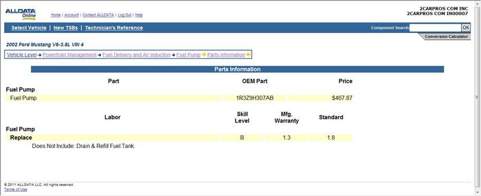

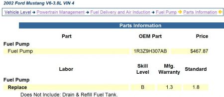

I had my fuel pump replaced and it costs $725.00. I just want to know if that is a correct price?
Sunday, January 13th, 2019 AT 5:55 PM (Merged)
  • 75,992 POSTS
https://www.2carpros.com/forum/automotive_pictures/12900_f_19.jpg
Note: Part and labor varies with location.
Labor cost range from $70.00-$130.00 an hour.

Hi. I am in the process of getting my Ford 2002 Mustang V6 fuel pump replaced and was quoted $245.00 for the part and $180.00 for the labor. Labor will be two hours because they will need to drop the tank. This part is new from a reputable company.
STEVE W.
  • 15,608 POSTS
Sounds like a good price. The labor is the part that can add up quick on some repairs. For instance many AC or heater cores are not that expensive, but because many vehicles need to have the entire dash removed to get to them you get a bill with the parts at $200.00 but over $1,000.00 in labor due to the time it takes to remove and replace the entire assembly.
