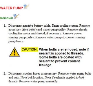

1997 Ford Mustang water pump
1997 FORD MUSTANG
MARBELLO23
Engine Cooling problem
1997 Ford Mustang 6 cyl Two Wheel Drive Automatic
is there anywhere i can find a step by step guide to replacing my water pump

https://images.2carpros.com/forum/automotive_pictures/307763_Noname_11.jpg

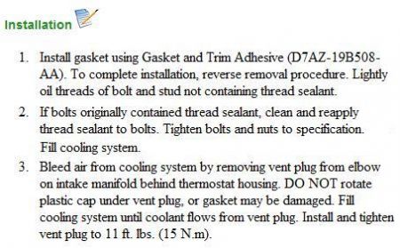

https://images.2carpros.com/forum/automotive_pictures/307763_Noname2_4.jpg
