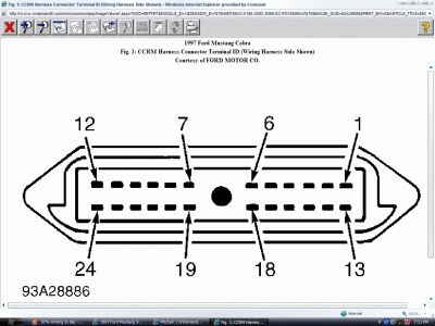

I have a 97 mustang cobra and the cooling fan is not coming on. I cant find the relay for the fan. It works when I turn on the a/c but nothing for hot temp. New radiator, thermostat, and temp sensor.

You may need to test a dew circuits in the CCRM(Constant Control Relay Module) Under the hood, Can be a blown fuse link, or fuse.
https://www.2carpros.com/forum/automotive_pictures/62217_CCRMa_2.jpg
https://www.2carpros.com/forum/automotive_pictures/62217_CCRMd_1.jpg
