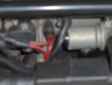

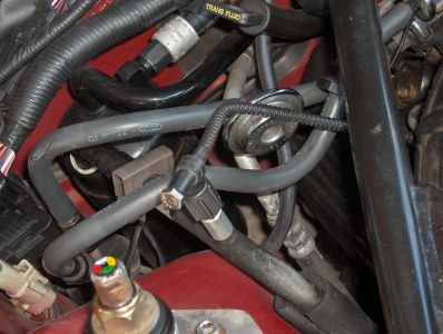

https://www.2carpros.com/forum/automotive_pictures/371298_HPIM0227_1.jpg
https://www.2carpros.com/forum/automotive_pictures/371298_HPIM0228_1.jpg
First picture is of the end of the line, second is where it comes out of the throttle body.
