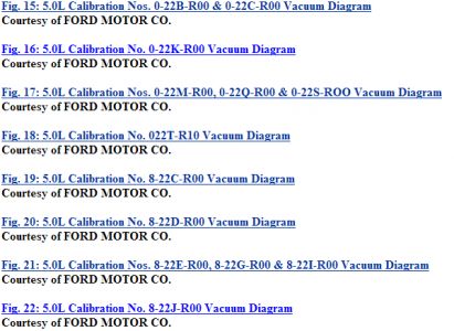

ok so here goes my boyfriend has a 1995 ford mustang and he put a motor and transmission from a 1990 ford crown victoria in it first of all he cannot figure where all the vaccuum lines go but here is the biggest problem: it will start and run perfect every time you try but when you put it into gear it dies even if you keep one foot on the brake and one on the gas it still dies when you put it in gear. Any suggestions? Your help would be greatly greatly appreciated. THANX!

Wich PCM and Ignition modules is he using? He needs to use the Crown Vic Mods...and figure out the vacuum using the Crown vic Vacuum diagram. If he can figure out the ebgine calibration code for the new engine, I can post the diagram. The codes look like this.
https://www.2carpros.com/forum/automotive_pictures/62217_codes_2.jpg
