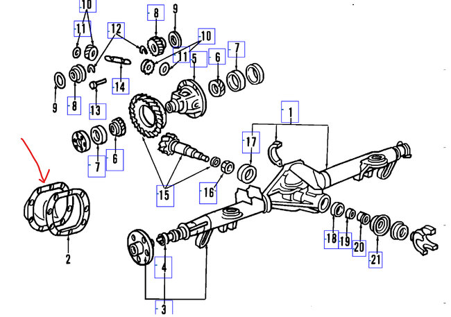

when i give it gas it sounds like the whole rear end is falling out, i changed the U joints if i did this right any idea on what this could be?

This sounds like the ring or pinion gear is having an issue, to confirm the problem let's remove the rear read fluid cover to inspect the gear teeth and fluid condition. Here is a generic guide to help you step by step with instructions in the diagrams below to show you how on your car.
https://www.2carpros.com/articles/differential-service
