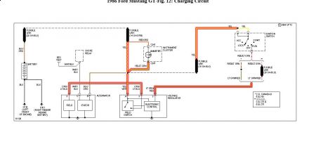

am losing electrical power while driving. Headlights will just go out while I am driving. It has new battery, and new alter. All this started after my brother try to install a stereo.

Get the alternator load tested just to be sure if its putting out.

Done replace the alternator three times and the battery a couple of times still nothing

Check and test the fusible links blue and brown and also check the ammeter
