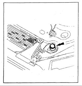

Cannot find ac high pressure port?
Found low pressure port passenger side under wheel well liner!! Was told it is near radiator???
Jul 13, 2010 at 3:33 PM
  • CAR REPAIR CONTRIBUTOR
  • 75,992 POSTS
A/C HIGH PRESSURE SERVICE PORT VALVE LOCATION The HIGH-pressure service gauge port valve is located on the A/C condenser and can be accessed through an opening in the left hand top of the radiator grille opening panel reinforcement..
https://images.2carpros.com/forum/automotive_pictures/12900_ac_9.jpg

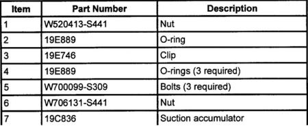

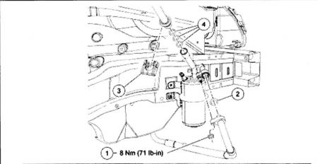

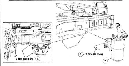

A/C LOW PRESSURE SERVICE PORT VALVE LOCATION The low-pressure service gauge port valve is located on the suction accumulator and can be accessed from below the right hand side of the front bumper cover.
https://images.2carpros.com/forum/automotive_pictures/12900_l1_3.jpg
https://images.2carpros.com/forum/automotive_pictures/12900_l2_3.jpg
https://images.2carpros.com/forum/automotive_pictures/12900_l3_2.jpg
