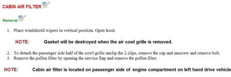

How to remove screen to replace filter
has glue or something cant remove
Thursday, August 26th, 2010 AT 10:05 PM
BLUELIGHTNIN6
MECHANIC
16,542 POSTS
Friday, August 27th, 2010 AT 5:49 PM
