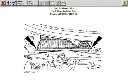

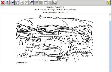

Hello does my car model have a cabin air filter that I can replace?
Monday, June 23rd, 2008 AT 3:10 PM
MECHANIC
75,992 POSTS
Yes it does see below
