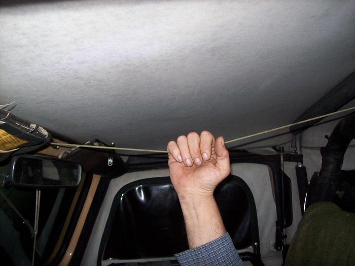

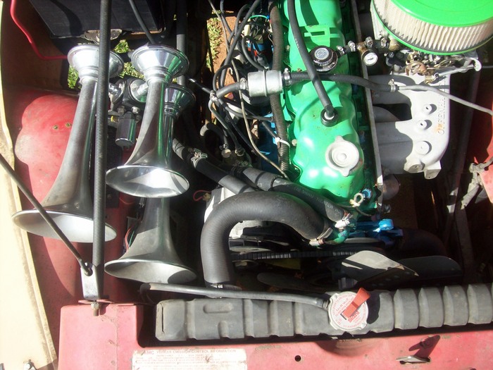

Forget the wimpy factory toy
No need to mess with steering wheel!
Want to be in Command in a bad situation?
Install a real horn!
