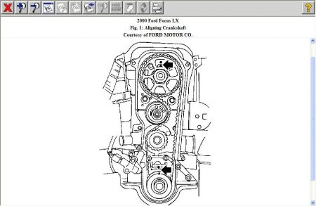

2000 Ford Focus HOW DO U CHANGE A TIMMING BELT AND LINE IT
DEMONSPYDER
  • 2000 FORD FOCUS
2000 Ford Focus 4 cyl Front Wheel Drive Automatic
NEEDED TO FIND OUT HOW TO CHANGE A TIMMING BELT AND HOW TO LINE THE BELT UP RIGHT. BECAUSE I'M STUCK ON IT. AND IF YOU CAN ASNWER THIS I WOULD REALLY BE GREATFUL

Which engine do you have?
2.0 4cyl VIN B & 3 or 2.0 4cyl VIN P ?
Below is for 2.0 4cyl SOHC VIN P
Make sure you put engine no.1 piston on its compression stroke then line the sprockets then install the belt.
https://www.2carpros.com/forum/automotive_pictures/12900_timing_marks_2.jpg
