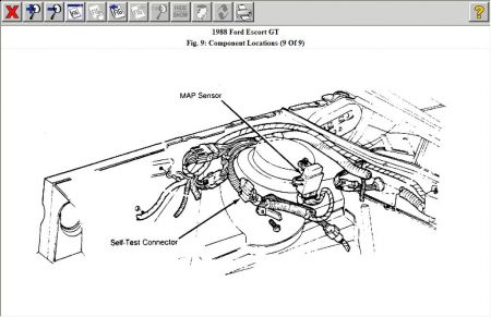

heyy I have a ford falcon 88b and im wondering where to find the diagnositc cable I beleve its called to see wats wrong with the car ive had a look over the engine and am not to sure where to find it thanks tom

I believe you're looking for the self test connector the problem is there's no data about this vehicle in my auto references or Mit1
Here's for a 1988 ford escort location might be at the same location
https://www.2carpros.com/forum/automotive_pictures/12900_self_test_connector_1.jpg

Hi there,
If this is an Australian EA Falcon, the connector is under the brake master cylinder it is a large elongated plug with one extra wire attached.
