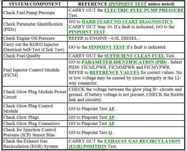

I was driving and my diesel just shut off and would not start. The water in fuel indicator was on previous to this problem, so I changed all of the fuel filters and drained the fuel lines and the problems still persists. ANY SUGGESTIONS!

Hi Dan da man,
Thank you for the donation and sorry for the delay in answering. Had a hard time trying to get the necessary info.
Carry out the following preliminary checks:
Engine for correct oil level and viscosity.
Clean fuel.
Intake restriction.
For the 6.0 L engine, low oil level and pressure would cause non starting. Here is a list of diagnostics. Do the basic test and let me know what additional procedures that you require.
https://www.2carpros.com/forum/automotive_pictures/192750_HardStart06FordF350_2.jpg
