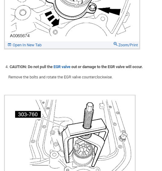

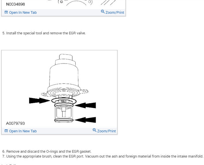

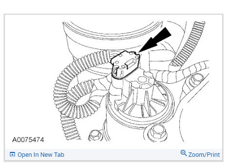

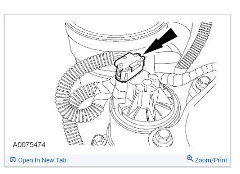

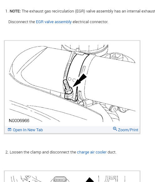

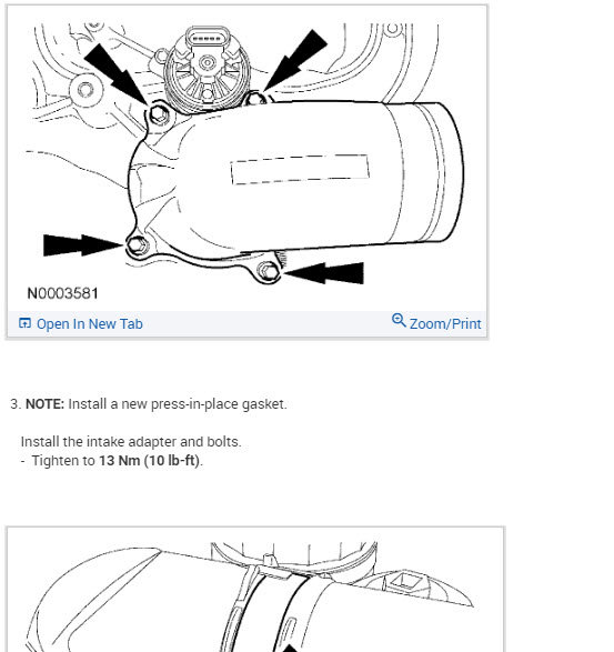

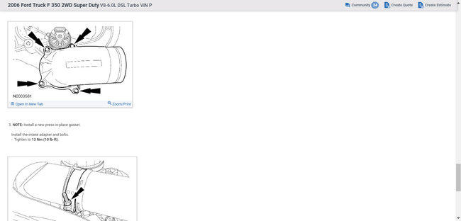

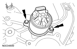

where is the EGR valve located on the truck listed above with a 6.0 power-stroke v-8?

The EGR valve should be seated in the intake manifold held by two bolts.

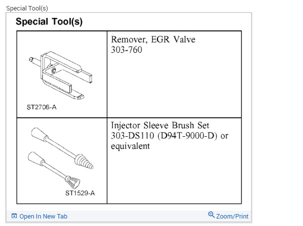

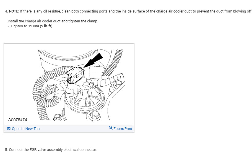

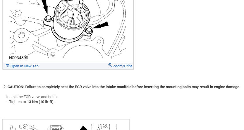

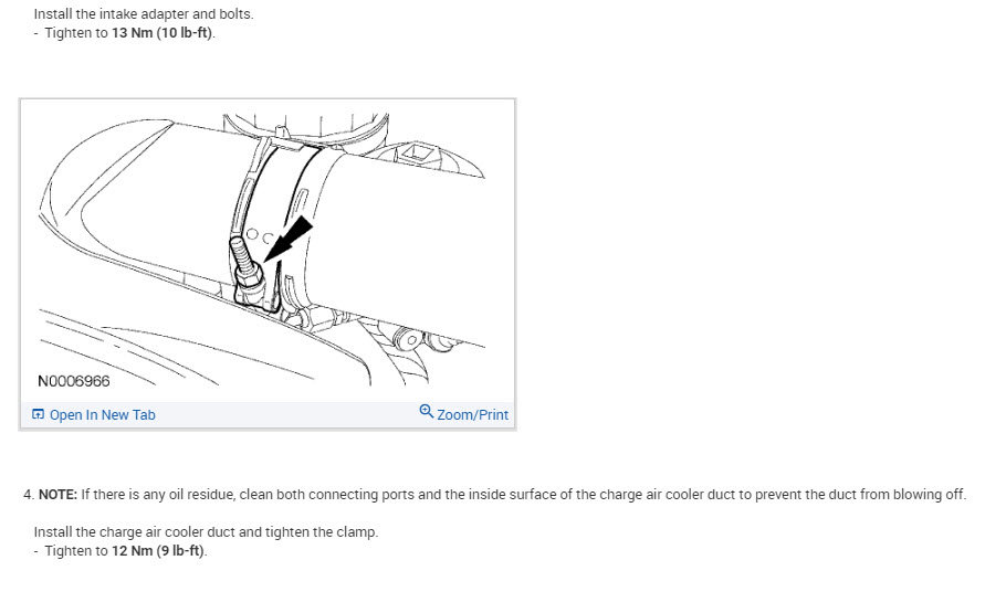

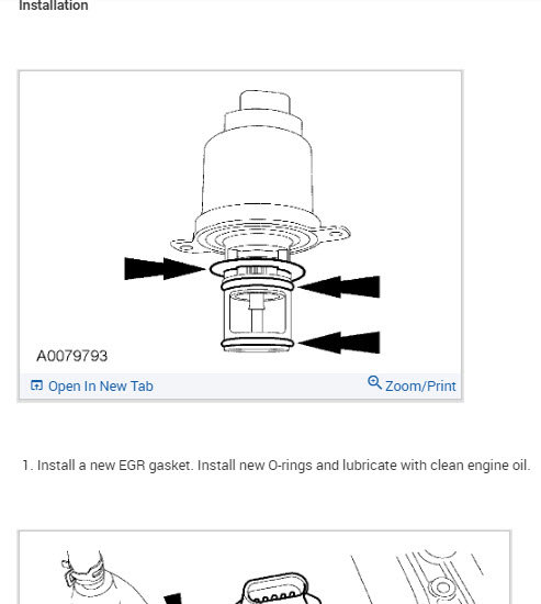

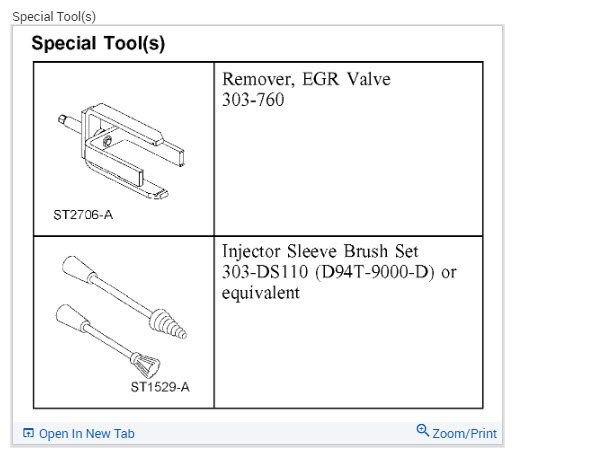

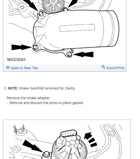

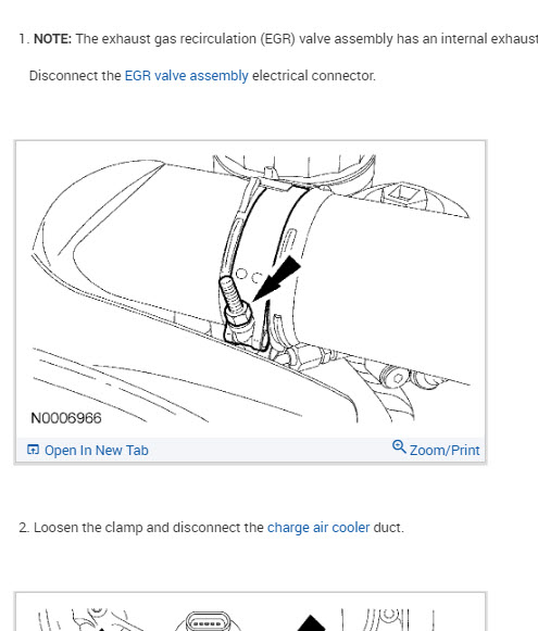

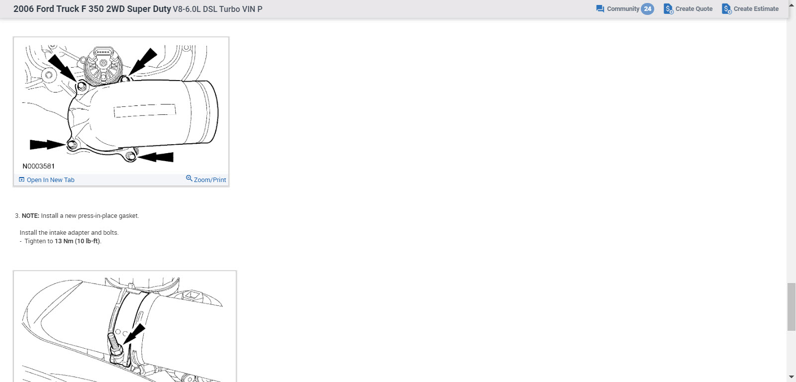

There are special procedures for removing the valve because of excess carbon build-up. I have attached the procedure and special tool numbers.
