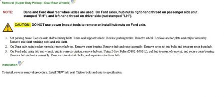

how do i get the rear rotors off this f-350 dually?
