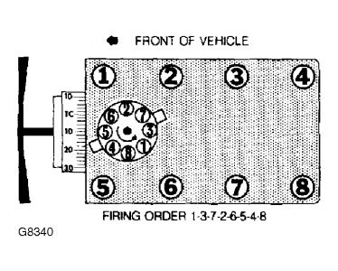

I need the firing order and the distributor turn
Saturday, August 28th, 2010 AT 12:32 PM
BLUELIGHTNIN6
MECHANIC
16,542 POSTS
5.8L shown below, let me know if yours is different engine size..
