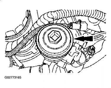

Where are the fuel filters located on an F-250 super duty, 6.0 turbo diesel? Do you have step by step directions on changing those filters?

Remove filter lid remove filter replace and replace lid. See pic below.
