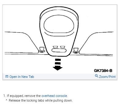

How do yu remove the overhead console? This one has a display for temp/mileage/fuel mileage and 2 compartments for sunglasses and garage door opener.

Removal and Installation
Remove the overhead console.
Remove the screw, disengage the clips, and disconnect the electrical connectors.
This is the only picture I could find for removing it
