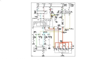

We have tried and tried to figure out why the brake lights will not come on. We can not seem to find an online wiring manual to try to follow. Can anyone point me in the right direction on how to figure out why the brake lights will not come on? Thank you

You can start by checking the brake switch follow the barke pedal arm till it meets the brake support bracket its right here. Could be the multifunction switch and fuse no.13 15amp
https://images.2carpros.com/forum/automotive_pictures/12900_brake_circuit_1.jpg
