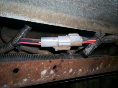

Here is what I have for the wiring at the front tank.
Sending unit side Wiring harness side
Black Black
Black/PinkRed
Gray/RedOrange
Yellow/WhiteYellow/Blue

That kept me wondering. If the connector is unplugged, the fuel gauge should not move from bottom of gauge.
Plug in the connectors. Turn ignition ON and then OFF again. Unplug the connector and then turn ignition switch ON. Does the gauge reading go past Full?
Problem seems to be from gauge rather than sensing unit.
With connector unplugged, test the resistance between the Yellow/White of sending unit connector and body ground. Is resistance between 5 to 100 ohms?
If possible, get 2 different resistor of 10 and 50 ohms. Connect either one in series between the Yellow white wires and turn on ignition switch. Note gauge reading. Change resistor and retest.

For the fuel gauge to register Empty, the sending unit must be providing a high resistance, most probably in the region of 100 to 105 ohms to ground.
In this instance, it could be a bad/poor ground that is increasing the resistance.
This could be related to the interior lights coming on when the brake pedal is depressed. Check the ground circuit at rear taillights. Clean and retighten them to see if the problem is resolved.

Ok, I got under the truck with my meter. With the key off I tested the Black and Blue/Yellow wire on the wiring harness side of the midship tank. I got 155 ohms. Then I went from the yellow/white wire to the gas tank as my ground on the midship tank 1494 ohm. I could not produce any results with the rear tank. I tried both the ways as the midship tank and switched the fuel to rear tank, nothing.
