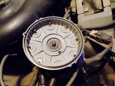

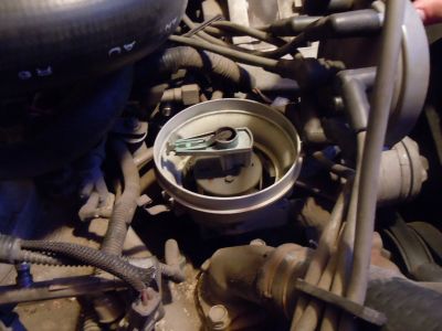

I got spark, I tested the #4 cylinder wire. Here are the pictures I took. I was not sure if I should take a picture of the inside or outside of the dist. cap so I took a pic of the inside.
https://www.2carpros.com/forum/automotive_pictures/567881_308_1.jpg
https://www.2carpros.com/forum/automotive_pictures/567881_309_1.jpg
https://www.2carpros.com/forum/automotive_pictures/567881_310_1.jpg

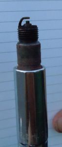

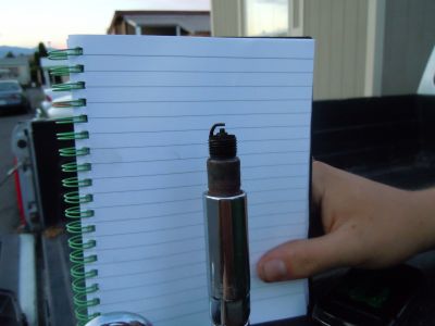

Maybe this is a better pic of the spark plug. The plug looked crappy to me
https://www.2carpros.com/forum/automotive_pictures/567881_308_crop_1.jpg

I don't think it will be a total fix but the center button on the cap looks over worked along with the rotor and the plugs look like it is running a bit rich. So I would replace the cap, rotor, spark plugs and the O2 sensor. Let me know how it runs after that.
