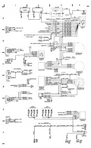

DOCFIXIT
  • 18,828 POSTS
https://www.2carpros.com/forum/automotive_pictures/198357_Graphic_666.jpg
Tried to send wiring but comes out WAY to small
Trying to understand when you turn key to start starter operates but engine will not run? and starter keeps cranking even though key is released?
With test light on NEG termoinal of coli does it flash on and off when cranking?

DUSTYROAD
  • 8 POSTS
No it stays on but just gets a little dimmer.
Can you send the diagram in PDF Format?
