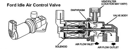

I have to feather the throttle to start the engine, and keep feathering to keep it running. While depressing throttle the engine chokes, and upon release of throttle the engine picks up. Plugs looked fine for 20k on them, wires etc are same age. High pressure (external) pump was replaced along with filter since problem began, no results. Haven't gotten it to run without being on and off the throttle. Fuel in tank is from June '09, but I've ran rigs on much older fuel. Engine is Jasper reman'ed, installed Aug '06. Last time I drove the truck, it acted similar on start-up but much less severe. At the time it seemed to have around 40% power or so.

Dunno if its an EFI system and a 5.0L engine if so check and test the throttle air bypass solenoid, EGR and PCV valves and the throttle position sensor-If not get back asap.

Yes, EFI 5.0L. Has that weird TBI injection setup. Rookie question, but how do you check those? Had a scanner for it, but it got dropped in my last move.
Technically it's called a TFI-IV system.

Find the throttle air bypass solenoid/IACV and clean it out and also the EGR valve-
http://www.2carpros.com/forum/automotive_pictures/12900_idle_air_solenoid_ford_1.jpg

Ok I cleaned the IACV and EGR valve, also checked voltage and resistance. Everything seemed to be working correctly. The EGR valve spring seemed a little rough to move when I removed it, and smooth actuating when I put it back on, with no difference. I have yet to check the TPS, but I'll be replacing that if it needs to come off anyway as it's a PITA and inexpensive.
