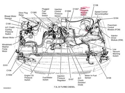

I have a 96 ford f-150 2w 4.9 175000 miles.
brake lights wont work. Checked bulbs and fuses, all ok. Replaced stop light switch. Tail lights, turn signals, and back up lights work. Noticed the other day cruise control does not work. Read on a previous form that there are 2 senors on the break pedal, one for brakes, and one for cruise? All wireing appears intact.
any help you could give would be fantastic!

Check on the left frame rail beneath drivers floor...This is the Brake pressure applied switch, it turns off the cruise control replace it and you should be ok!
http://www.2carpros.com/forum/automotive_pictures/62217_Brake_switch_copy_1.jpg
