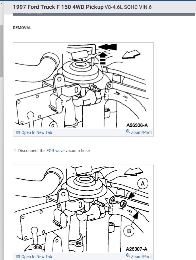

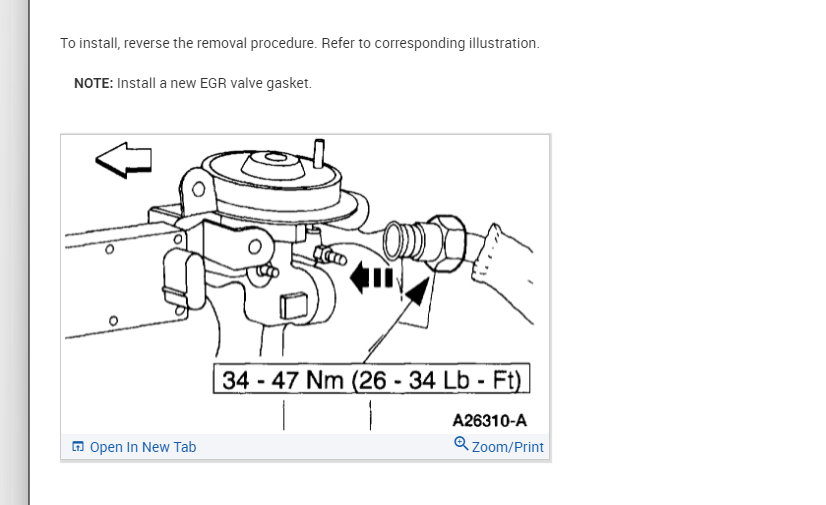

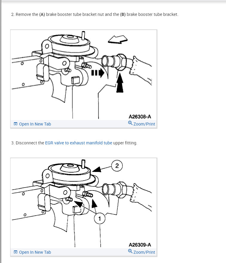

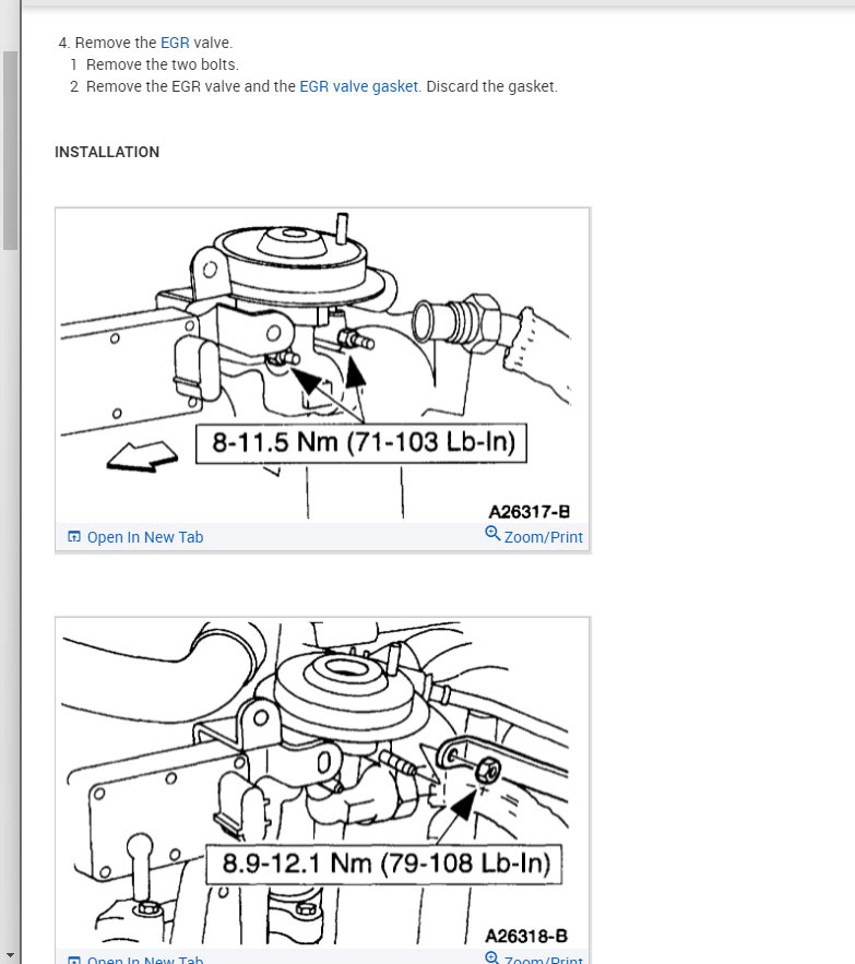

How do I change an EGR valve on the truck listed above? It has a 4.6 engine.
Saturday, March 25th, 2006 AT 12:00 PM
I will attach this info below but is there a reason you are looking to replace it?
I assume you have some codes so if you want to supply the codes you have, we can send you the testing that we need to run through in order to prove the valve is the issue.
Here is a guide that will help with getting the codes if needed:
Please see the attached info below on how to replace this. Let us know what questions you have. Thanks
