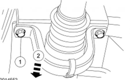

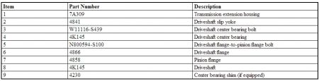

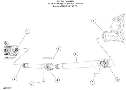

I would like to see the parts that I will need to replace this support.
