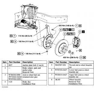

i have a ford 4x2 f150 4.6 lt, 6 stud, 2004 made in july truck, ive been having trouble finding the hub assembly part number, last they told me this model has the rotor attached to the hub assembly, can anyone help me find the right part number and if this model has the rotor and hub assembly all in one, where can i get a diagram?
thank you
ps it has ABS and is a 2WD
May 4, 2020 at 2:49 PM (Merged)
MHPAUTOS
  • CAR REPAIR CONTRIBUTOR
  • 31,937 POSTS
Hi there, I hope that this shows everything you need.
https://images.2carpros.com/forum/automotive_pictures/61395_ford_bearing_1.jpg
There are 2 rotors normal duty and heavy duty, P/No normal 8L3Z112B $215. Approx P/No heavy 8L3z112A $280. Approx. mark (mhpautos)

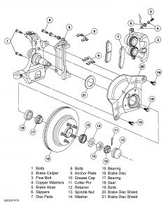

BMRFIXIT
  • 19,053 POSTS
lets start with this can you see what are you looking for
https://images.2carpros.com/forum/automotive_pictures/99387_Graphic_85.jpg
https://images.2carpros.com/forum/automotive_pictures/99387_Graphic1_721.jpg

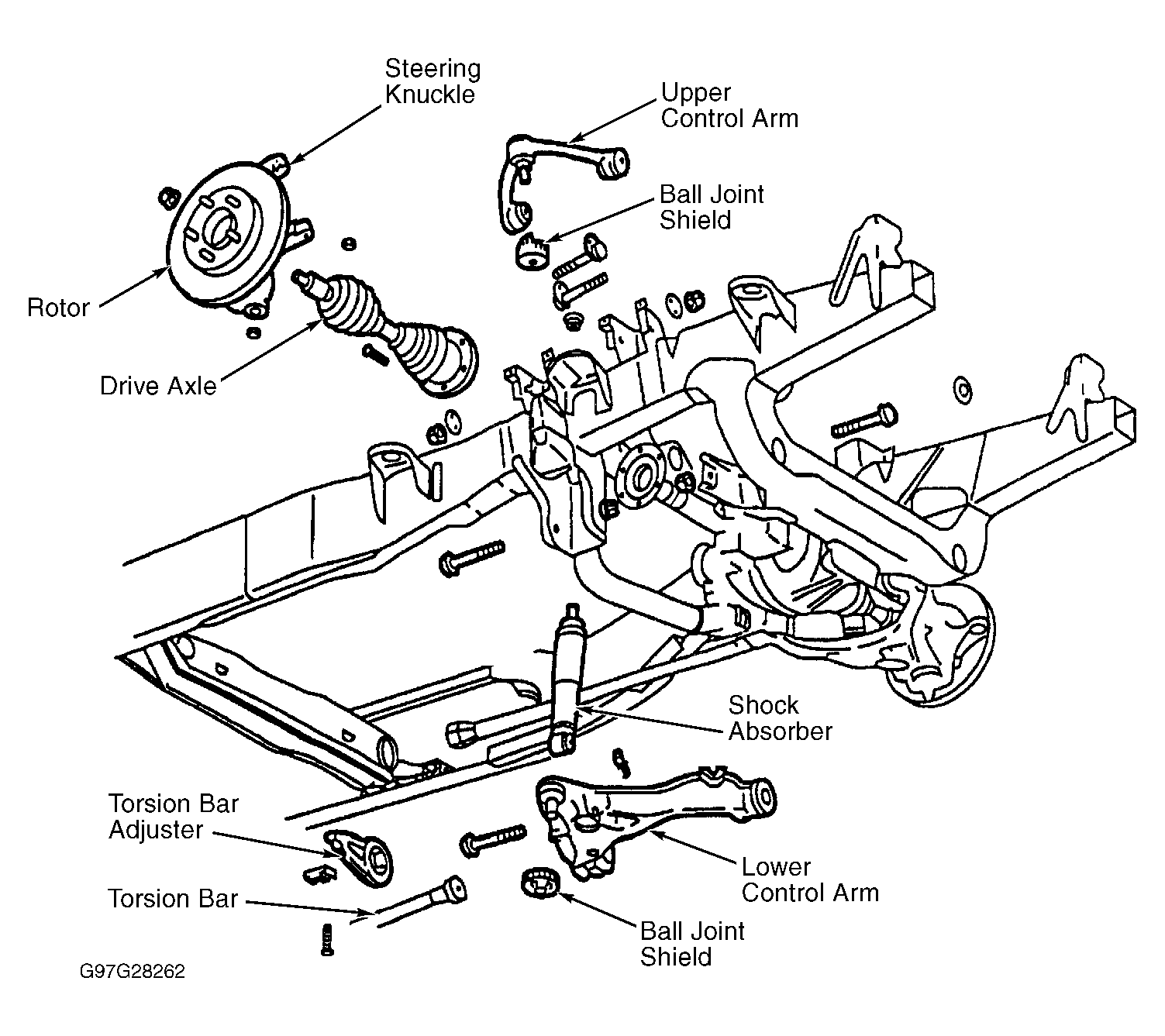

I have a 1997 Ford f-150 4wd. the ball joints need replacing, so i began the task. However, the axle shafts are stuck in the hub assembly. any ideas on how to get them out?
May 4, 2020 at 2:50 PM (Merged)
DOCFIXIT
  • 18,828 POSTS
Has upper ball joint been removed? May need to tap on axle with brass or rubber mallet. will need to remove torsion adjuster to remove lower "A" arm. see diagram

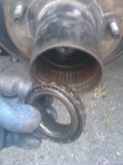

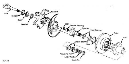

CPINTER10
how do i get my hub and rotor off on a 1990 ford f150? i have taken off the lock ring, the snap ring, hub body, outer locknut, lock washer, inner locknut, and a bearing. Is there still more I have to take off like another bearing or a c clip?
CPINTER10
this was the last thing that i have taken off. what more must i remove?
  • 110,190 POSTS
Double check for a retaining clip. Other than that, it looks like you removed everything.

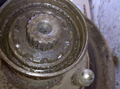

I am restoring my grandfathers 1979 F150. I am starting with rebuilding the front end with new bushings, shocks, brake pads, etc. The drivers side was no problem, but on the passenger side, it appears the standard lock mechanism was replaced somewhere along the way and I have no idea how to get it off so I can put a replacement one on. Attached is a picture. I am willing to research how to remove it if someone could just identify what year/make/model it is from. Thanks!
https://images.2carpros.com/forum/automotive_pictures/556141_20100725_12_47_54_1.jpg
MERLIN2021
  • 17,250 POSTS
It's from the same era, the picture below is an 84, does this look like it? There are two C clips on this before you remove the lock nuts, one on the inner edge of the hub and one on the axle shaft.
https://images.2carpros.com/forum/automotive_pictures/62217_Wheel_bearings_1.jpg
