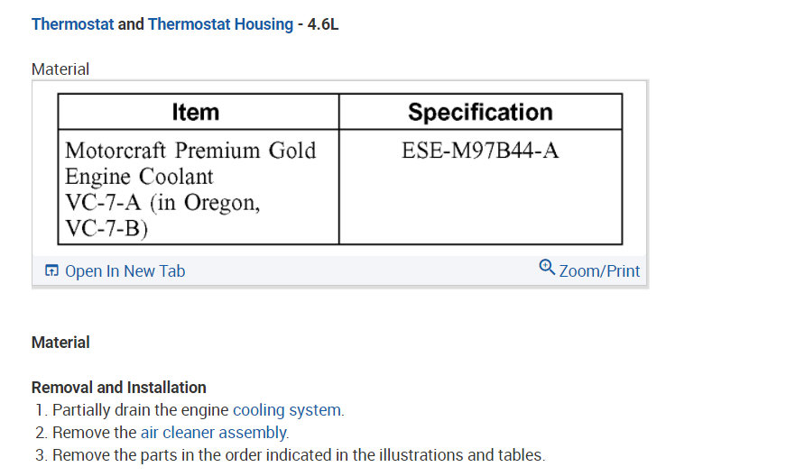

The temperature gauge skyrockets into the red only at high speeds (65-70 mph) and with the heater on.
Jan 21, 2008 at 4:52 AM
Good evening,

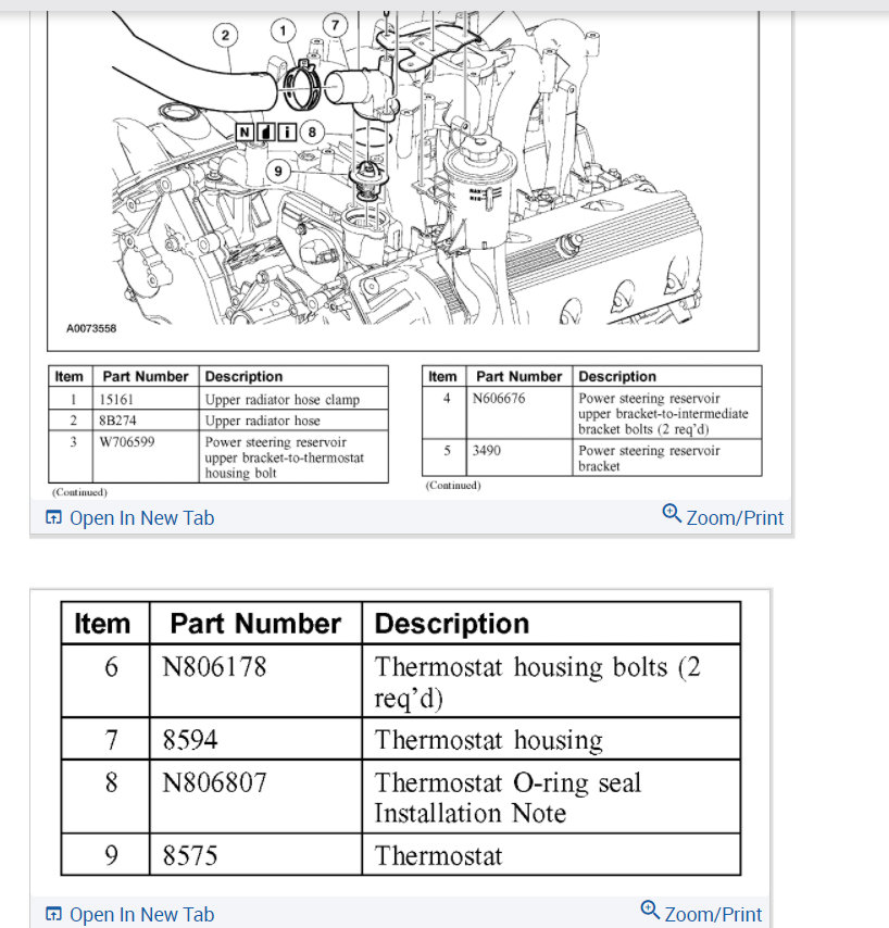

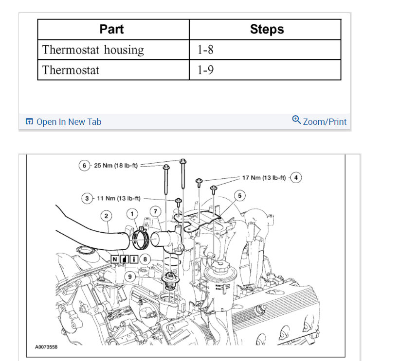

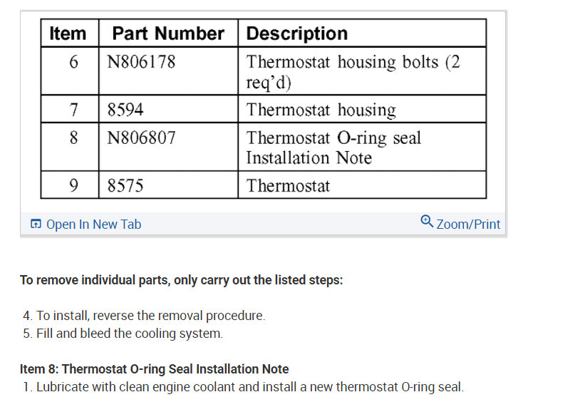

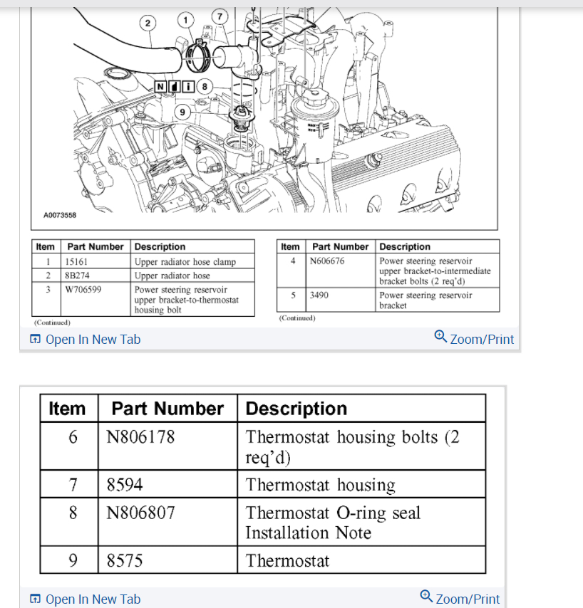

I attached the procedure for you of the replacement below. Here is a guide to help you step by step with instructions in the diagrams below to show you how on your car:
