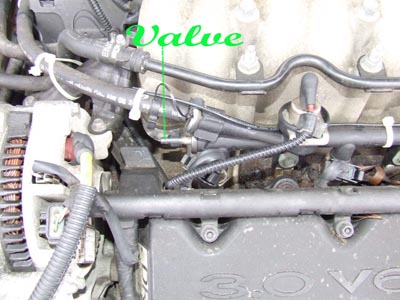

MERLIN2021
  • 17,250 POSTS
Well I have a 99 Sable and the test valve is at the end of the fuel rail. Looks like a bicycle tire valve stem...called a schreader valve. If you have a noid lite you can test each injector for power...
https://www.2carpros.com/forum/automotive_pictures/62217_Valve_003_1.jpg
Monday, April 2nd, 2007 AT 2:40 PM

K. Here is what I have. Disregard the 4000 rpm stumbling while in the drive way. Seems the computer has a limiter and this is normal. I have a 2001 that is mine that behaves in the same manner and stumbles at 4000. In fact the timing jumps to 40 degrees to cut out the engine on both the 2001 and the 2003. Back to the drawing board.
Next Steps:
I have an inline fuel pressure and compression tester on order. My 2001 has the test port on the injector rail. The 2003 has a sensor with wires and a vacuum line where the 2001's test port is. According to research, I will have to break into the fuel line to take this reading on the 2003. I will compare the 2001's and the 2003's fuel pressure to bench mark since the 2001 runs perfectly. This should verify the computer's sensor readings on the 2003. I will also check the compression on the cylinders.
Also, can anyone tell me what type of noid light to buy for this car?
