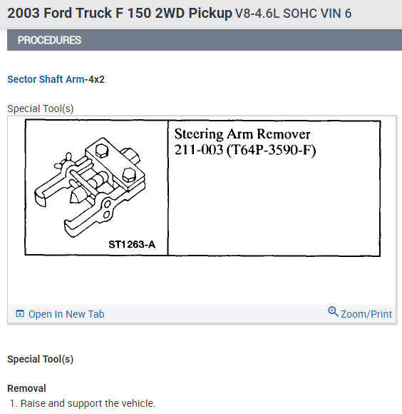

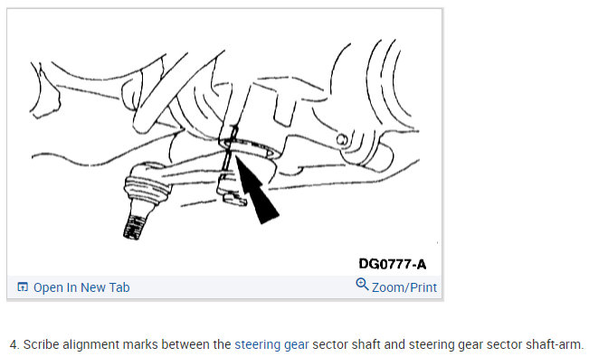

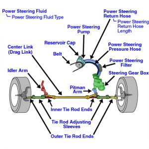

i am having trouble removing the steering box link from the steering bar. sorry if terminology isn't right.
Aug 3, 2010 at 10:14 AM
DANNY L
  • 5,648 POSTS
Hello, I'm Danny.

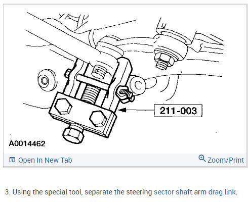

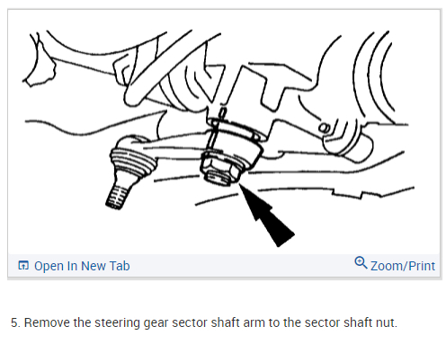

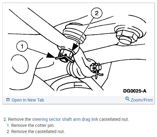

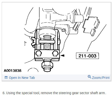

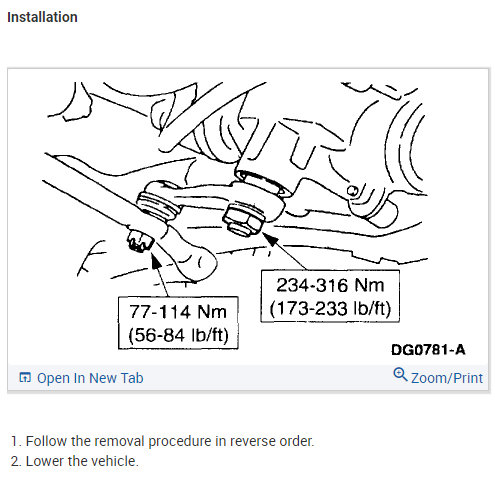

Here is the information you requested. It sounds like you are trying to remove the pitman arm from the steering link. The pitman arm to be removed requires a special tool due to the shear torque required of its installation. I've attached picture steps below for pitman arm removal and replacement on your Ford F-150. Hope this helps and thanks for using 2CarPros.
