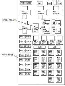

I was in a bad front end accident. The entire front end needed to be replaced. After that, the horn stopped working. I tried finding a answer in the Haynes repair book, no luck. I tracked down the cables and I found 1 dangling. I dont know where that connector should be connected. Not having a horn in SoCal isn't working for me. Can you help me out?

https://images.2carpros.com/forum/automotive_pictures/170934_horn_relay_2.jpg
The above picture is the power distribution center, under the hood.
https://images.2carpros.com/forum/automotive_pictures/170934_ford_horn_diagram_1.jpg
Check the circuits for voltage.
