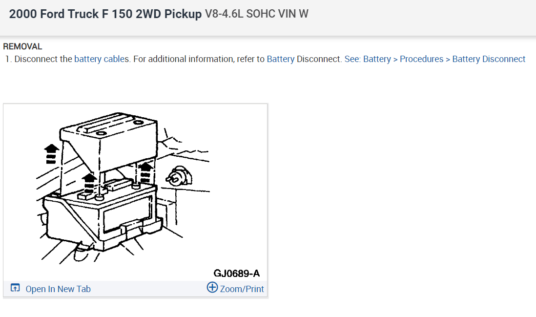

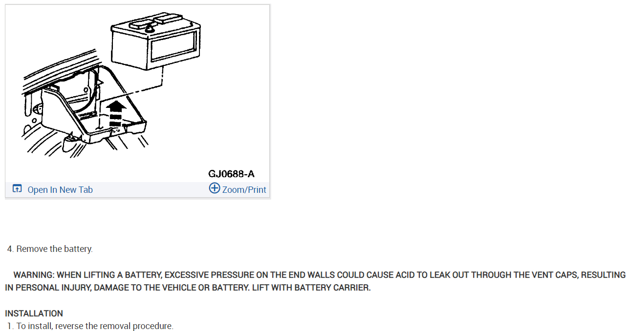

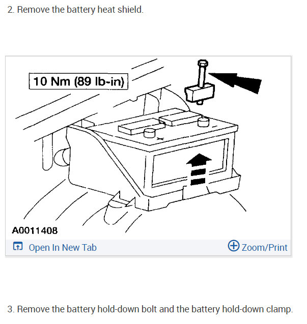

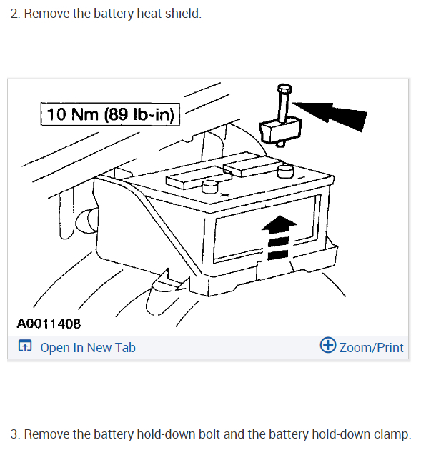

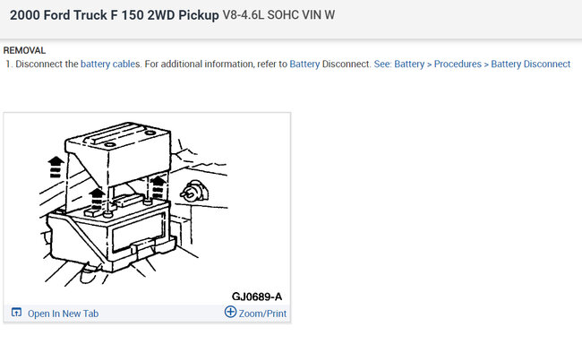

When you connect the batteries backward it can short the battery out internally and it will need to be replaced. Here is a guide to help you fix anything else that might be wrong.
https://www.2carpros.com/articles/resolving-reverse-battery-connection-in-cars-a-step-by-step-repair-guide
