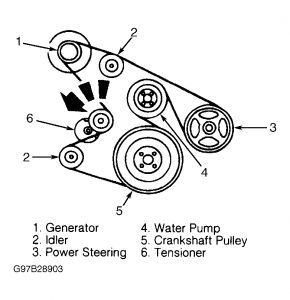

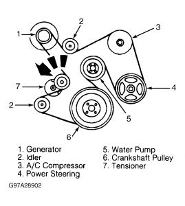

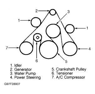

I need an image of the belt routing through the pully
Wednesday, July 30th, 2008 AT 6:41 AM
MHPAUTOS
MECHANIC
31,937 POSTS
Hi there,
i have posted 3 variants , i hope this is of help.
