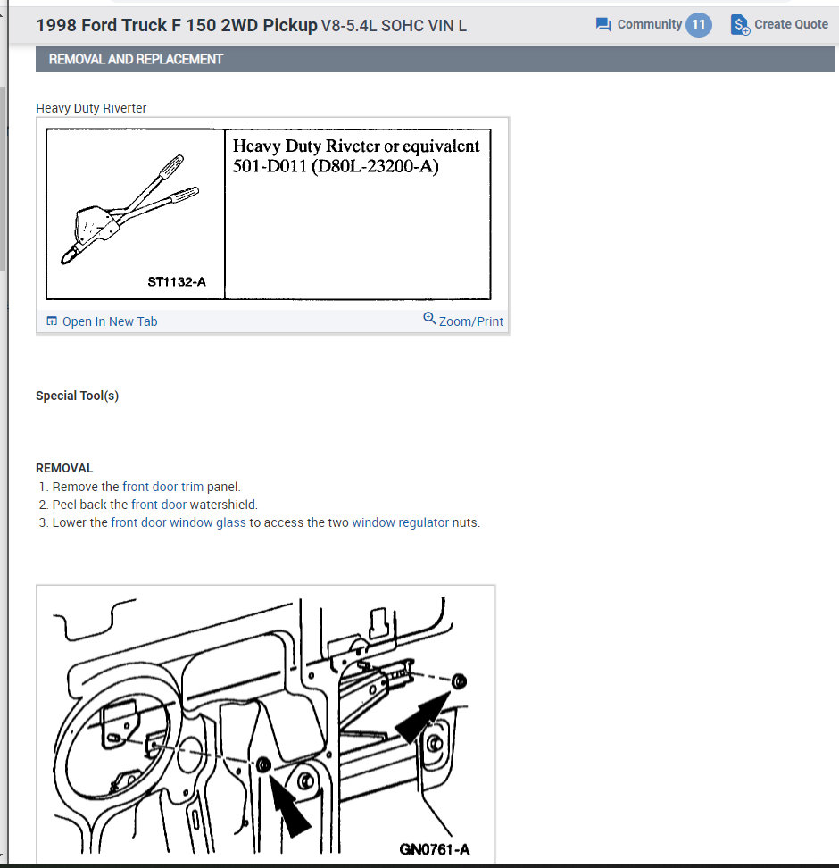

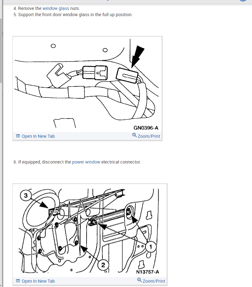

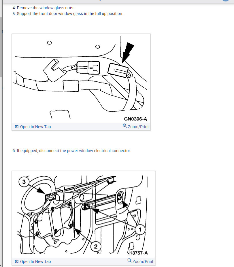

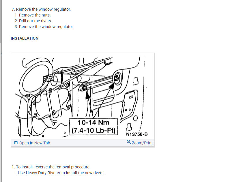

I need to know how to replace the motor for the driver side window?
Sunday, August 16th, 2009 AT 10:21 PM
MECHANIC
18,907 POSTS
Below you will find the process from the manual but here are a couple guides that will help with this:
https://www.2carpros.com/articles/how-to-check-and-replace-a-electric-power-window-motor
https://www.2carpros.com/articles/door-panel-removal
Please find the process from the manual on how to replace the window motor and regulator. Please let us know if you have other questions. Thanks
