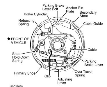

How can I tell the primary brake shoe and does that go towards front or rear?

Smaller lining goes to the front-primary. Check out the diagrams (Below). Please let us know if you need anything else to get the problem fixed.
