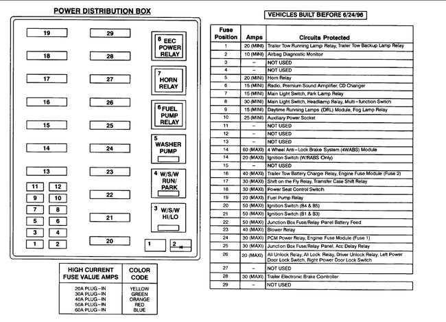

horn relay?
1997 FORD F-150
CRAZYTJANE
Horn relay location please can you help me I need it
Jun 4, 2010 at 9:41 PM
BLUELIGHTNIN6
  • CAR REPAIR CONTRIBUTOR
  • 16,542 POSTS
horn relay is on left side of engine compartment, in the power distribution box. Check out the diagrams (Below). Please let us know if you need anything else to get the problem fixed.
