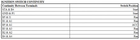

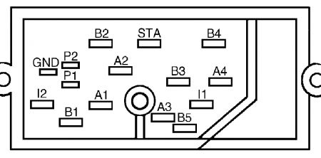

1997 Ford F-150 engine runs after key is turned off
JACK1141
  • 1997 FORD F-150
  • V8
  • 4WD
  • 175,000 MILES
My sysem lights stay on and discharges battery and when I charge the battery and reconnect dash lights come on without turning key.
Starts normally but when I turn off key engine stills keeps running.
When I disconnect battery engine stops

MERLIN2021
  • 17,250 POSTS
I would start with IGNITION SWITCH 1. To inspect ignition switch for mechanical operation, rotate lock cylinder through all switch positions. Lock cylinder should not bind, and should return from START to RUN position without assistance. 2. If binding or incorrect modes occur, ignition switch should be adjusted. After adjustment, if binding or incorrect modes still exist, lock cylinder should either be disassembled and inspected for damage, or ignition switch should be replaced. 3. To test electrical function of ignition switch, disconnect ignition switch connector. Check continuity between specified switch terminals using a self-powered test light or ohmmeter. See Fig. 2 or Fig. 3 . See IGNITION SWITCH CONTINUITY TABLE. If continuity is not as specified, replace ignition switch.the ignition switch.
https://www.2carpros.com/forum/automotive_pictures/62217_150a_2.jpg
https://www.2carpros.com/forum/automotive_pictures/62217_150b_2.jpg
