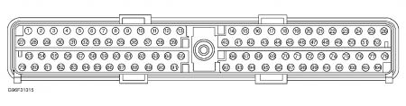

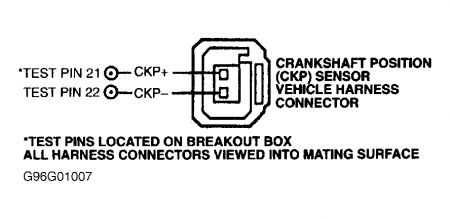

Try these tests for the CKP.. ignore the bit about a breakout box unless you have one .. you can use digital voltmeter instead !!
http://www.2carpros.com/forum/automotive_pictures/266999_pcm_3.jpg
http://www.2carpros.com/forum/automotive_pictures/266999_ckp_5.jpg
Step 1) Check Spark Plugs & Wires Remove and check spark plugs. Check all spark plug wires for damaged insulation or poor connectors. Check primary ignition wiring. Check CKP sensor connector. Repair or replace if necessary. If no faults are found, go to next step.

Step 4) Check CKP Circuit To PCM Turn ignition off. Disconnect scan tester from DLC. Disconnect PCM. Check PCM wiring harness connector for damage and repair if necessary. Install Breakout Box (014-000950). Connect PCM wiring harness connector to breakout box. Turn ignition on. Measure voltage between pin No. 21 (CKP+) at breakout box and negative battery terminal. If voltage is not 1-2 volts, go to next step. If voltage is 1-2 volts, go to step 10).
Step 5) Check CKP Sensor Turn ignition off. Disconnect CKP wiring harness connector. Turn ignition on. Measure voltage between pin No. 21 (CKP+) at breakout box and negative battery terminal. If voltage is 1-2 volts, go to next step. If voltage is not 1-2 volts, go to step 18).
Step 6) Leave ignition on. Measure voltage between pin No. 22 (CKP-) at breakout box and negative battery terminal. If voltage is 1-2 volts, replace CKP sensor and repeat QUICK TEST . If voltage is not 1-2 volts, go to next step.
Step 7) If voltage in step 6) was less than 1.0 volt, go to next step. If voltage in step 6) was more than 1.0 volts, go to step 9).
Step 8) Turn ignition off. Disconnect PCM from breakout box. Measure resistance between pin No. 22 (CKP-) at breakout box and negative battery terminal. If resistance is more than 10,000 ohms, replace PCM and repeat QUICK TEST . If resistance is 10,000 ohms or less, repair CKP- circuit short to ground.
Step 9) Leave PCM disconnected from breakout box. Turn ignition on. Measure voltage between pin No. 22 (CKP-) at breakout box and negative battery terminal. If voltage is less than 0.5 volts, replace PCM and repeat QUICK TEST . If voltage is 0.5 volts or more, repair CKP sensor short to power and repeat QUICK TEST.
Step 10) Set DVOM on AC voltage scale. Crank starter while measuring voltage between pin No. 21 (CKP+) and No. 22 (CKP-) at breakout box. After stabilizing, if AC voltage is less than 0.4 volt, go to next step. If AC voltage is 0.4 volt or more, go to step 60) under CIRCUIT TEST JE.
Step 11) Turn ignition off. Disconnect PCM from breakout box. Set DVOM on AC voltage scale. Crank starter while measuring voltage between pin No. 21 (CKP+) and No. 22 (CKP-) at breakout box. After stabilizing, if voltage is less than 0.4 volt, go to next step. If voltage is 0.4 volt or more, replace PCM and repeat QUICK TEST .
Step 12) Turn ignition off. Measure resistance between pin No. 21 (CKP+) and No. 22 (CKP-) at breakout box. If resistance is 300-800 ohms, go to step 16). If resistance is not 300-800 ohms, go to next step.
