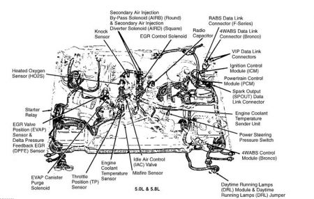

Can somebody please tell me where the EGR pressure sensor is located on a 1996 f150? If you could inlude pictures, that would be great, thank you very much!

EGR Valve Position (EVP) sensor is located on the top left rear of engine, on the throttle body.. 5.0L & 5.8L engine shown below...
https://www.2carpros.com/forum/automotive_pictures/261618_Noname_1617.jpg
