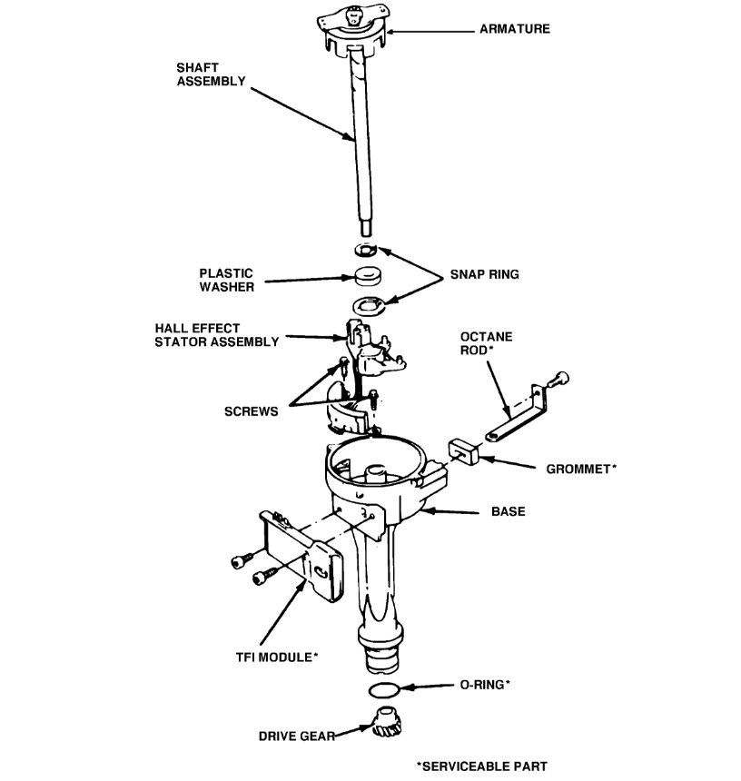

How difficult is it to replace an ignition module in a 91 ford f150.
Friday, September 11th, 2009 AT 12:53 PM
MECHANIC
75,992 POSTS
The ignition module is on the side of the distributor held on by 5.5 mm bolts. Here is a diagram to show you how.
