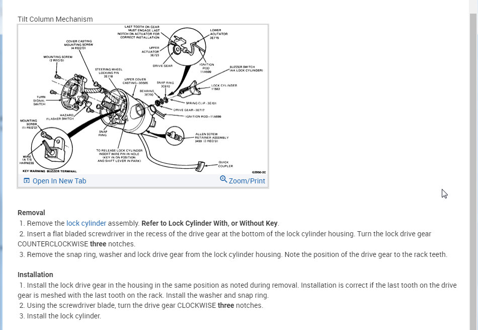

My dad has a 1990 Ford F150; the steering wheel will turn but the ignition switch is locked. How can I get the ignition switch out? And it wont turn.
-1
Tuesday, July 14th, 2020 AT 10:29 AM

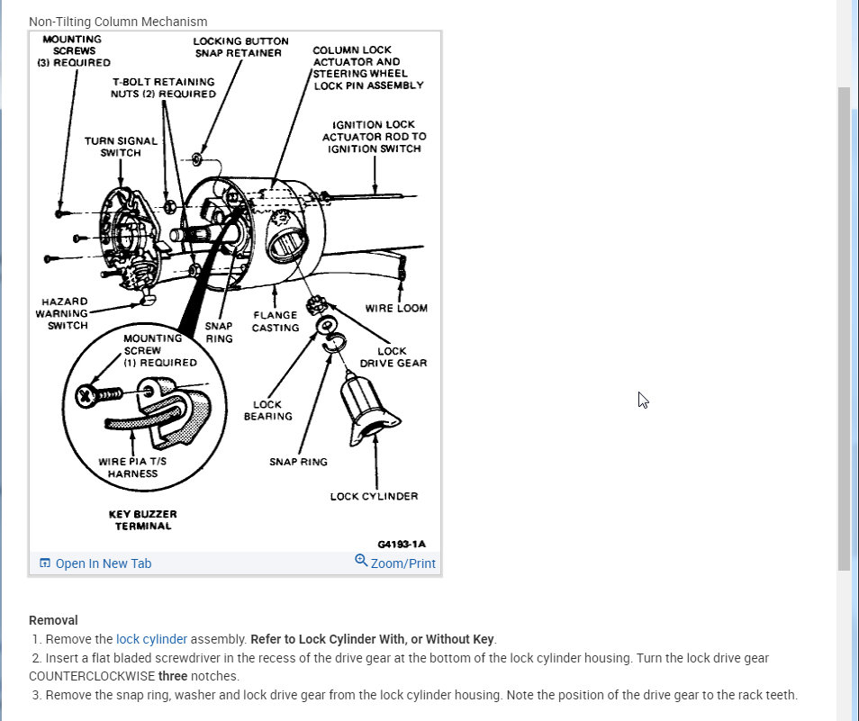

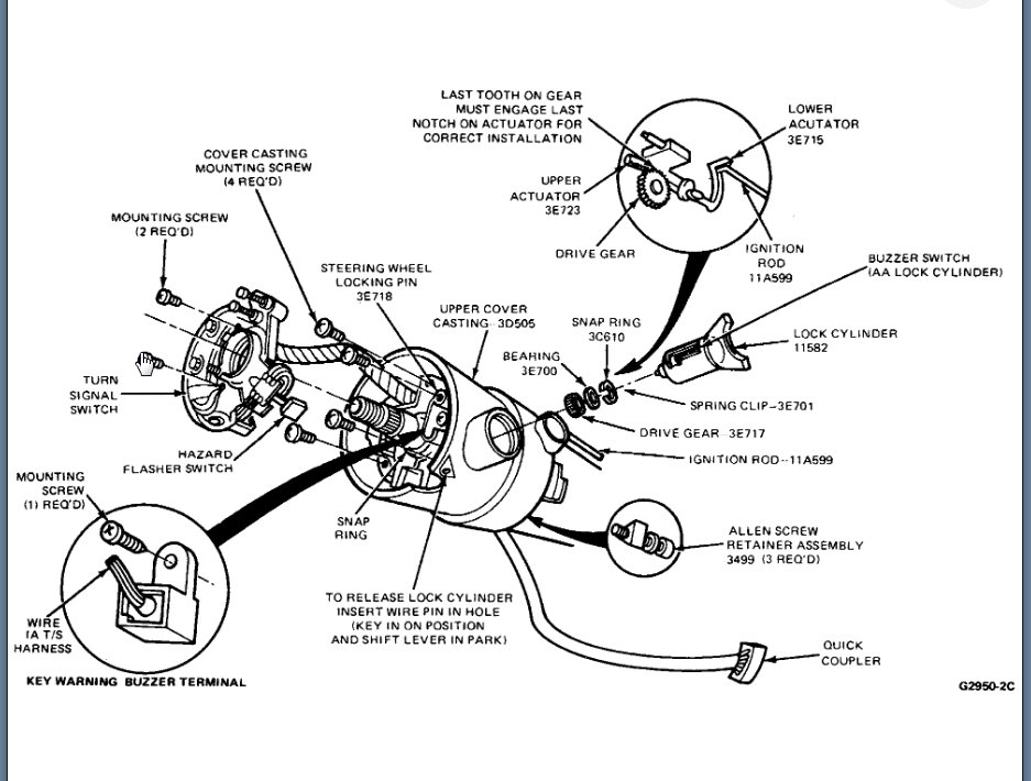

This is most likely the ignition switch lock. Normally it locks the steering wheel as well but there may be damage to the gear. Either way, I attached the process on the ignition lock gear. I would suggest removing this and getting into just to see what is going on it there.
Let me know what you find. I included the process for both tilt and non tilt columns.
