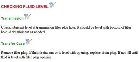

where do you check for the trans fluid there isn't any dip stick.
isn't this a free sight if you don't what to answer just forget about it I will find out on my own thanks anyway.

https://images.2carpros.com/forum/automotive_pictures/261618_Noname_2056.jpg
