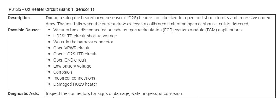

I m getting codes p0135, p0141, p0155, p0161, p0403, p0443 and p0645.
I read many forums for these kinds of faults in vehicles.
Which finally concluded to PCM. Even a guy from garage was saying that for Ford explorer 2007-2010, its very common failure. PCM model number is 9l2a-12a650-fd.
I have already opened it.
My best guess is there is some problem in ground circuit of PCM.
But i m not able to diagnose it.
I just need assistance how to repair PCM for these codes.

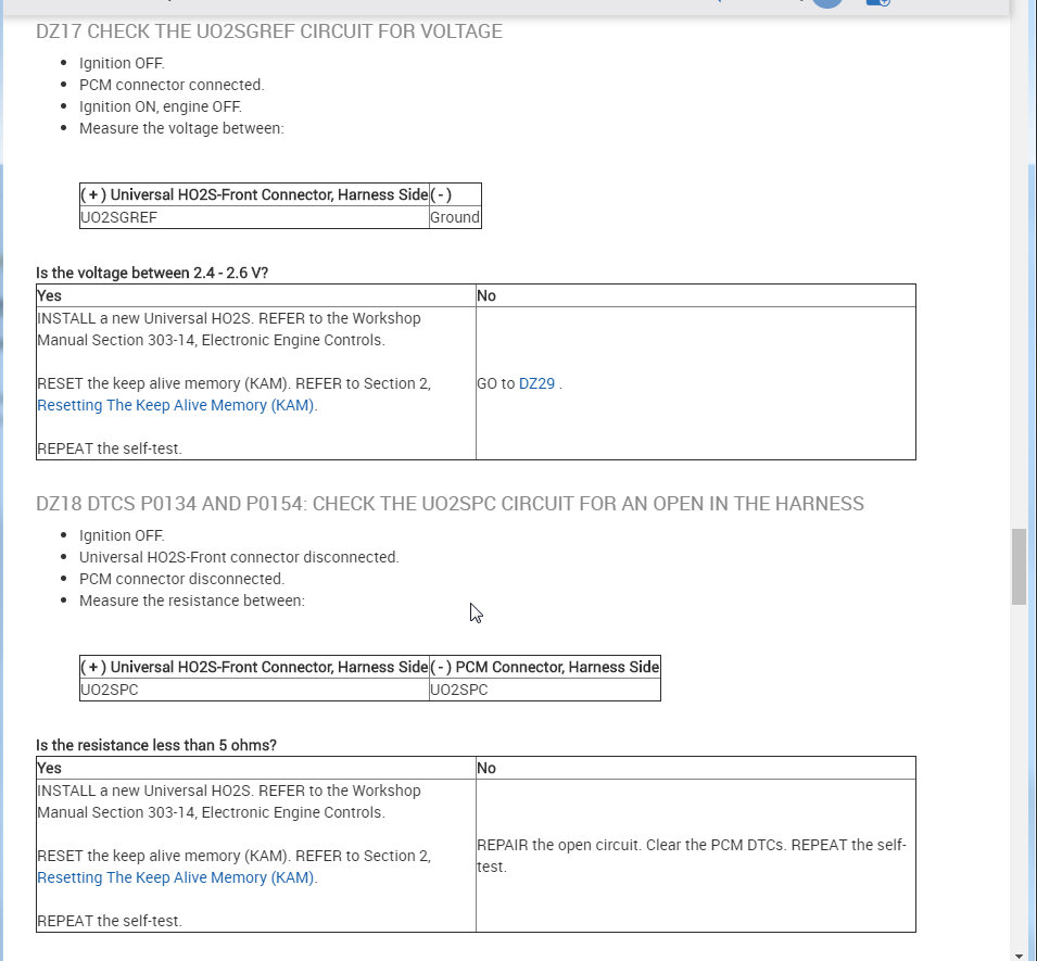

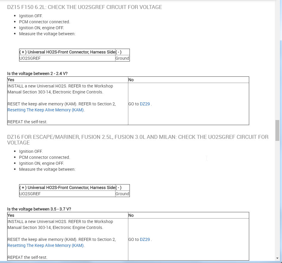

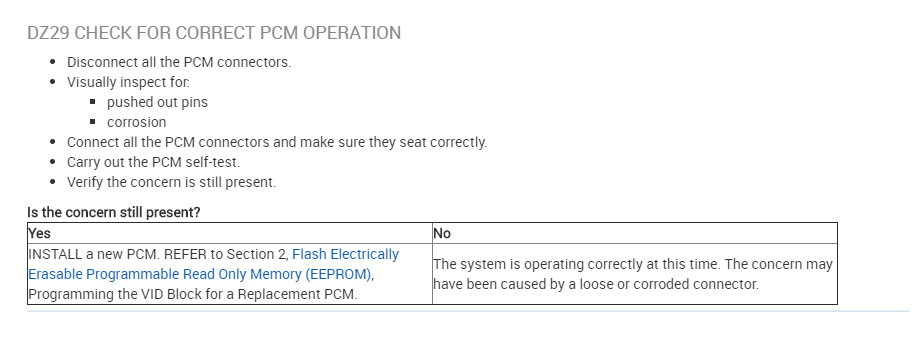

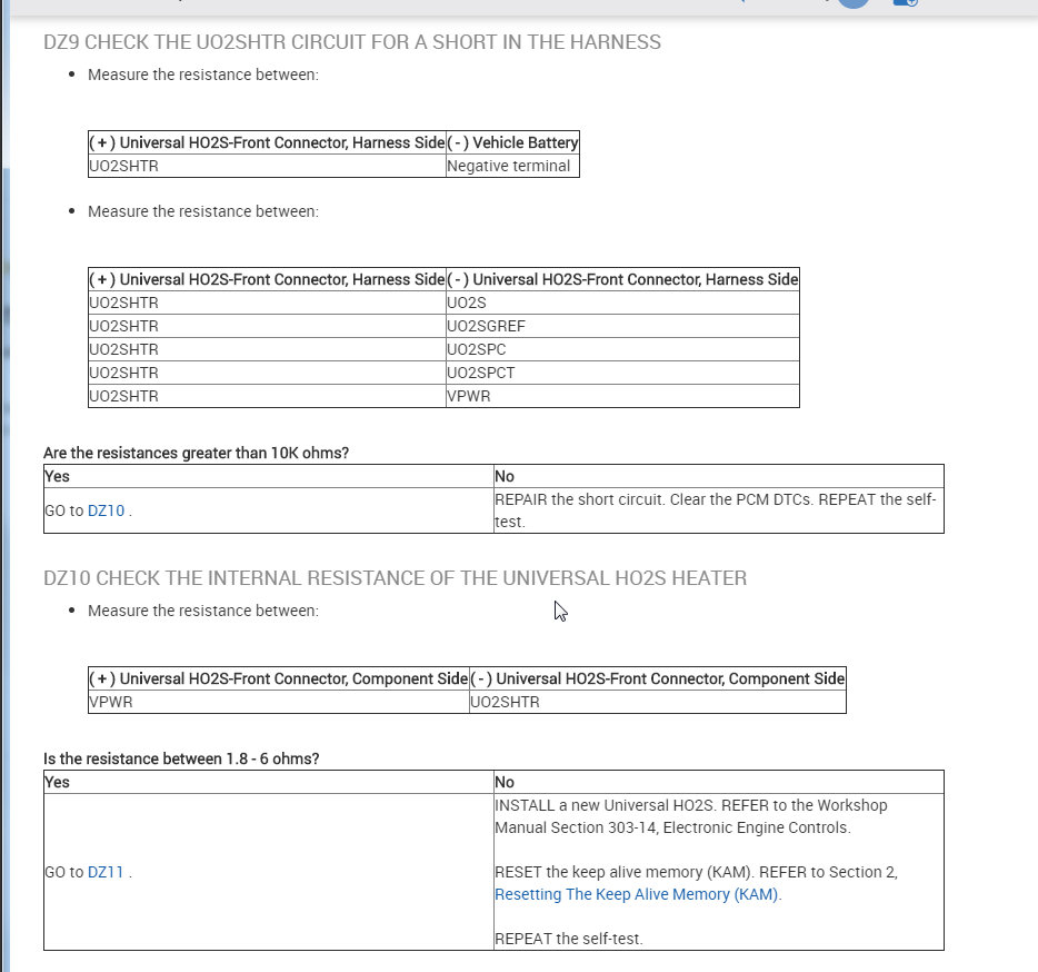

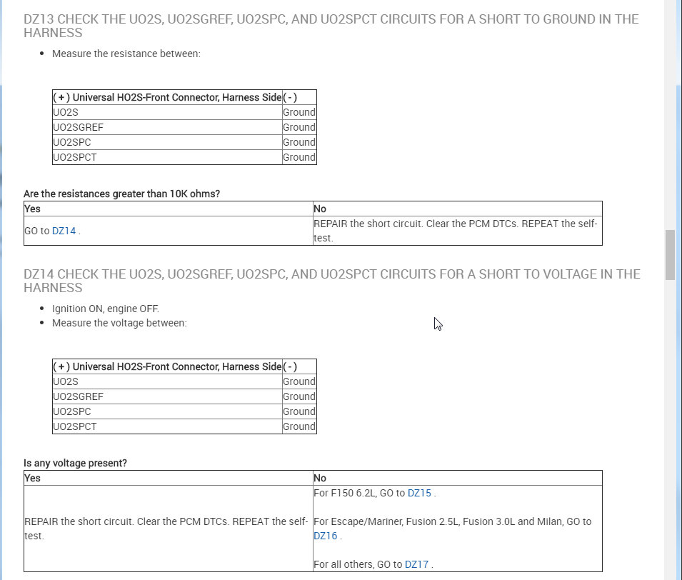

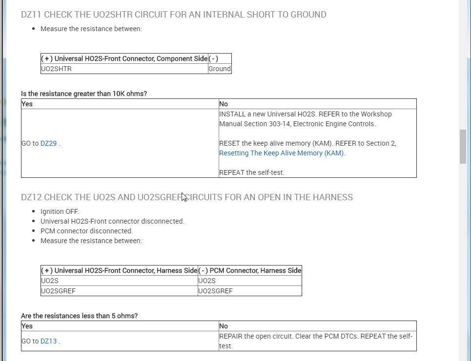

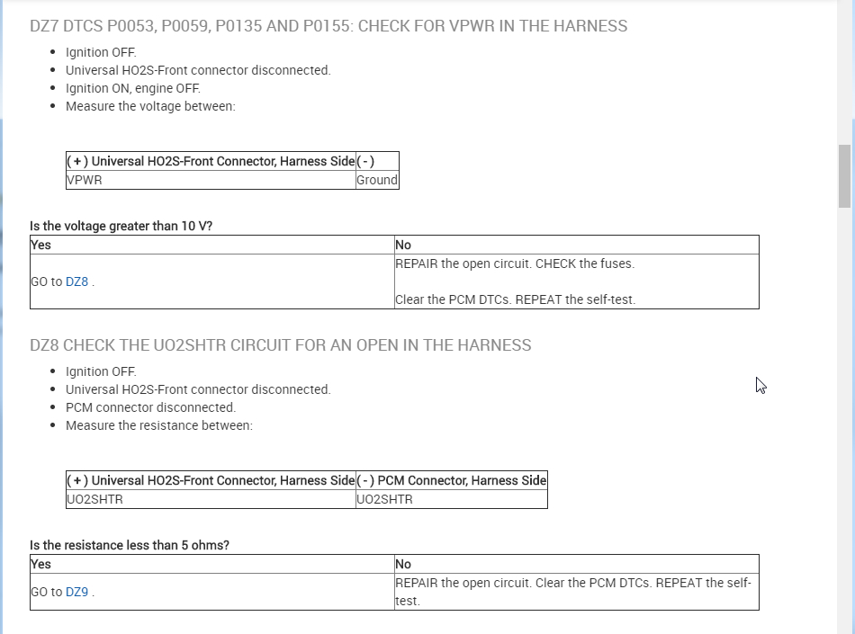

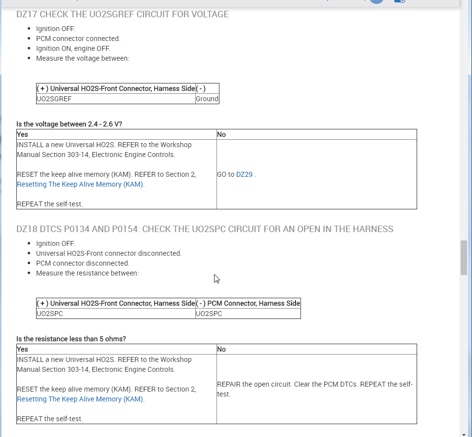

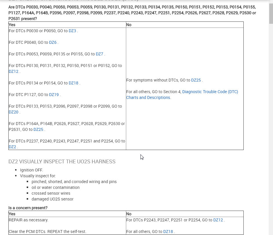

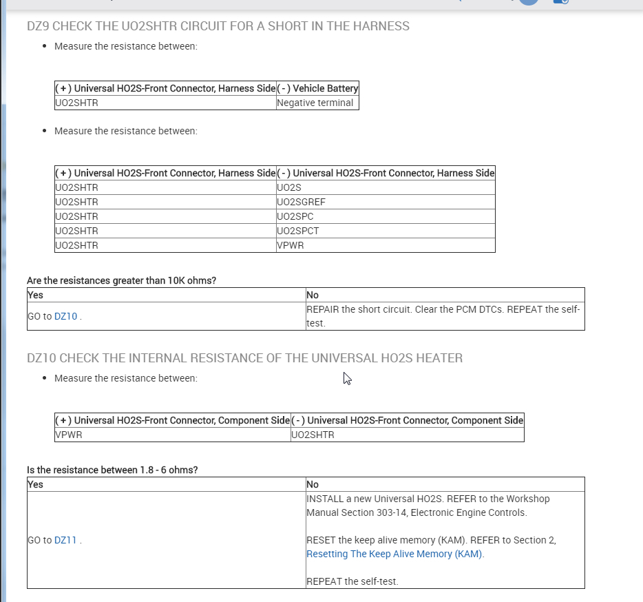

Okay. That helps and I think you are exactly correct. I suspect the PCM ground circuit has failed. Assume they are all related as there is a chance that you have multiple issues but the common component is the PCM. Each of the o2 codes is pointing you to the P0135 code so let's chase that one down and fix it and then retest.
I attached the testing but I suspect you will get through it and it will say to replace the PCM. If you are going to try and repair it then that may work. Unfortunately, I normally just replace it and not worry about trying to repair it.
Let us know what you find.

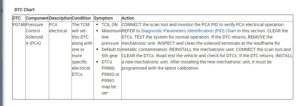

it was faulty PCM. I got it repaired. But the moment it reconnected it, car started showing wrench light, with P0748 and P0960 fault codes. What shall i check first?
Dec 6, 2020 at 4:04 PM
We need to get a new post started for these issues because they are different. Unfortunately others won't find the answers to them if we do it under this post.
The P0748 is for the pressure control solenoid and the other is related to it.
I attached some info on this. Let's get a new post started and we can figure this out. Thanks
