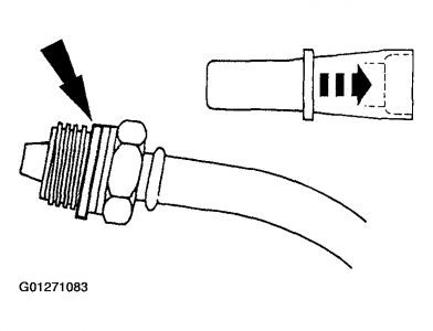

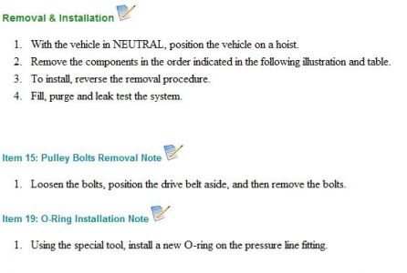

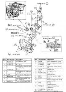

BLUELIGHTNIN6
MECHANIC
16,542 POSTS
Thursday, June 3rd, 2010 AT 9:26 PM
