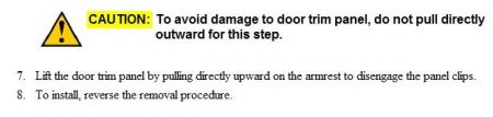

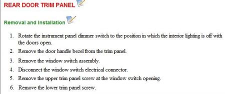

My right rear window fell down in the door. How do I get the door cover off to get to the window? I may need to replace the automatic regulator.

https://images.2carpros.com/forum/automotive_pictures/261618_Noname_2296.jpg
https://images.2carpros.com/forum/automotive_pictures/261618_Noname2_755.jpg
