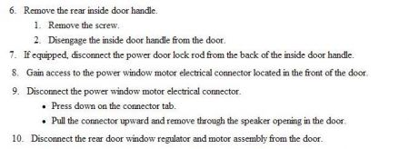

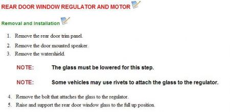

CAN SOMEONE TELL ME HOW TO GET THE RIVET OR RETAINER SCREW OUT OF THE WINDOR BRACE SO I CAN ATTACH THE NEW MOTOR/REGULATOR ASSEMBLY

if your vehicle has rivet instead of bolt you will have to drill the old rivet out first..
https://images.2carpros.com/forum/automotive_pictures/261618_Noname_1637.jpg
https://images.2carpros.com/forum/automotive_pictures/261618_Noname2_506.jpg
https://images.2carpros.com/forum/automotive_pictures/261618_Noname3_195.jpg
