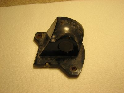

How do I remove the lens covering the courtesy lamp, located under the mirror on esch front door, to replace the bulb?

Remove the two screws from the underside of the mirror. The two screws are diagonally across from each other. Remove the bulb housing pictured below.
Remove and replace bulb and lightly tighten the two screws.
